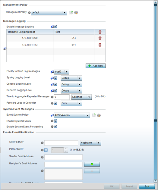

    Device Overrides - Management Settings Screen
  4. Refer to the Management Policy field to set or override a management configuration for this profile.
    A default management policy is also available if no existing policies are usable.
    Use the drop-down menu to select an existing management policy to apply to this profile. If there are no management policies that meet the data access requirements of this profile, click the Create icon to access screens used to define administration, access control, and SNMP configurations. Alternatively, select an existing policy and click the Edit icon to modify the configuration of an existing management policy. For more information, see Viewing Management Access Policies.
  5. Refer to the Message Logging field to define how the profile logs system events.
    It is important to log individual events to discern an overall pattern that might be negatively impacting performance.
    Enable Message Logging Select this option to enable the profile to log system events to a log file or a syslog server. Selecting this check box enables the rest of the parameters required to define the profile‘s logging configuration. This option is disabled by default.
    Remote Logging Host
    Use this table to define numerical (non DNS) IP addresses for up to three external resources where logged system events can be sent on behalf of the profile. Select the Delete icon as needed to remove an IP address.
    Facility to Send Log Messages Use the drop-down menu to specify the local server (if used) for profile event log transfers
    System Logging Level Event severity coincides with the syslog logging level defined for the profile. Assign a numeric identifier to log events based on criticality. Severity levels include 0 - Emergency, 1 - Alert, 2 - Critical, 3 - Errors, 4 - Warning, 5 - Notice, 6 - Info and 7 - Debug. The default logging level is 4.
    Console Logging Level Event severity coincides with the syslog logging level defined for the profile. Assign a numeric identifier to log events based on criticality. Severity levels include 0 - Emergency, 1 - Alert, 2 - Critical, 3 - Errors, 4 - Warning, 5 - Notice, 6 - Info and 7 - Debug. The default logging level is 4.
    Buffered Logging Level Event severity coincides with the syslog logging level defined for the profile. Assign a numeric identifier to log events based on criticality. Severity levels include 0 - Emergency, 1 - Alert, 2 - Critical, 3 - Errors, 4 - Warning, 5 - Notice, 6 - Info and 7 - Debug. The default logging level is 4.
    Time to Aggregate Repeated Messages Define the increment (or interval) system events are logged on behalf of the profile. The shorter the interval, the sooner the event is logged. Either define an interval in seconds (0 - 60) or minutes (0 -1). The default value is 0 seconds.
    Forward Logs to Controller Select this option to define a log level for forwarding event logs to the control. Log levels include Emergency, Alert, Critical, Error, Warning, Notice, Info and Debug. The default logging level is Error.
  6. Refer to the System Event Messages field to define or override how controller or service platform system messages are logged and forwarded on behalf of the profile.
    1. Select an Event System Policy from the drop-down menu.
      If an appropriate policy does not exist, click Create to make a new policy.
    2. Select Enable System Events to allow the profile to capture system events and append them to a log file.
      It is important to log individual events to discern an overall pattern that may be negatively impacting controller or service platform performance. This setting is enabled by default.
    3. Select Enable System Event Forwarding to forward system events to another controller, service platform or cluster member.
  7. Refer to the Events E-mail Notification field to define or override how system event notification emails are sent.
    SMTP Server Specify either the hostname or IP address of the outgoing SMTP server where notification emails are originated. Hostnames cannot include an underscore character.
    Port of SMTP If a non-standard SMTP port is used on the outgoing SMTP server, select this option and specify a port from 1 - 65,535 for the outgoing SMTP server to use.
    Sender E-mail Address Specify the email address from which notification email is originated. This is the from address on notification email.
    Recipient's E-mail Address
    Specify up to 6 email addresses to be the recipients of event email notifications.
    Username for SMTP Server Specify the username of the sender on the outgoing SMTP server. Many SMTP servers require users to authenticate with an username and password before sending email through the server.
    Password for SMTP Server Specify password associated with the username of the sender on the outgoing SMTP server. Many SMTP servers require users to authenticate with an username and password before sending email through the server.
