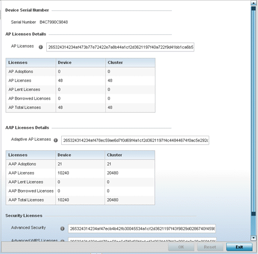

    Device Licenses Screen
    The License screen displays the Device Serial Number of the controller or service platform generating the license key.

  4. Review the AP Licenses table to assess the specific number of adoptions permitted, as dictated by the terms of the current license.
    AP Adoptions The Device column lists the total number of AP adoptions made by the controller or service platform. If the installed license count is 10 APs and the number of AP adoptions is 5, five additional APs can still be adopted under the terms of the license. The total number of APs adoptions varies by platform, as well as the terms of the license.
    The Cluster column lists the total number of AP adoptions made by the cluster membership (all members). If the installed license count is 100 APs and the number of AP adoptions is 50, 50 additional APs can still be adopted under the terms of the AP licenses, pooled by the cluster members.
    AP Licenses The Device column lists the number of APs available for adoption under the restrictions of the license. This number applies to dependent mode adaptive APs only, and not independent mode APs.
    The Cluster column lists the number of APs available for adoption by cluster members under the restrictions of the licenses, as pooled amongst the cluster members.
    AP Lent Licenses Lent licenses are the total number of AP licenses the NOC controller lends (if needed) to its site controllers so that a site controller can adopt APs in excess of its own installed AP license count. AP lent licenses can be non-zero only in controllers currently configured as the NOC (NOC controller). Lent Licenses is always zero in controllers configured as the site (site controller).
    AP Borrowed Licenses Borrowed licenses are the total number of AP licenses borrowed by the site controller from the NOC controller (NOC controllers if a NOC controller is in a cluster). AP borrowed licenses are always zero in the NOC controller. AP borrowed licenses can be non-zero only on site controllers.
    AP Total Licenses The cumulative number of both Device and Cluster AP licenses supported by the listed controller or service platform.

  5. Review the Adaptive AP Licenses table to assess the specific number of adoptions permitted, as dictated by the terms of the current license.
    AAP Adoptions The Device column lists the total number of AAP adoptions made by the controller or service platform. If the installed license count is 10 APs and the number of AAP adoptions is 5, five additional AAPs can still be adopted under the terms of the license. The total number of AAPs adoptions varies by platform, as well as the terms of the license.
    The Cluster column lists the total number of AAP adoptions made by the cluster membership (all members). If the installed license count is 100 APs and the number of AAP adoptions is 50, 50 additional AAPs can still be adopted under the terms of the AAP licenses, pooled by the cluster members.
    AAP Licenses The Device column lists the number of AAPs available for adoption under the restrictions of the license. This number applies to dependent mode adaptive AAPs only, and not independent mode AAPs.
    The Cluster column lists the number of AAPs available for adoption by cluster members under the restrictions of the licenses, as pooled amongst the cluster members.
    AAP Lent Licenses Lent licenses are the total number of AAP licenses the NOC controller lends (if needed) to its site controllers so site controllers can adopt adaptive APs in excess of its own installed AAP license count. AAP lent licenses can be non-zero only in controllers currently configured as the NOC (NOC controller). Lent licenses is always zero in controllers configured as the site (site controller).
    AAP Borrowed Licenses Borrowed licenses are the total number of AAP licenses borrowed by the site controller from the NOC controller (NOC controllers if a NOC controller is in a cluster). AAP borrowed licenses are always zero in the NOC controller. AAP borrowed licenses can be non-zero only on site controllers.
    AAP Total Licenses Lists the cumulative number of both Device and Cluster AAP licenses supported by the listed controller or service platform.
