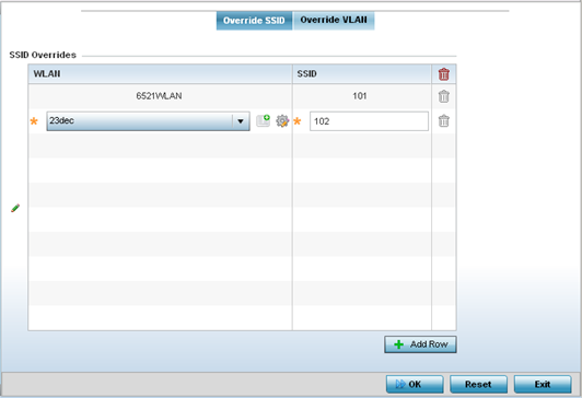

    WLAN Override screen - Override SSID Tab
  4. Define up to three overrides for the listed WLAN SSID assignment:
    WLAN Optionally use the drop-down menu to change the WLAN assignment for the listed access point. Click the Create icon to define a new WLAN configuration, or click the Edit icon to modify an existing WLAN configuration.
    SSID Optionally change the SSID associated with the WLAN. The WLAN name is auto-generated using the SSID until it is changed (overridden). The maximum number of characters used for the SSID is 32.
  5. Click + Add Row as needed to add additional WLAN SSID overrides.
    A blue override icon (to the left of a parameter) defines the parameter as having an override applied. To remove an override go to the Basic Configuration section of the device and click Clear Overrides. This removes all overrides from the device.
  6. Click OK to save the changes and overrides.
