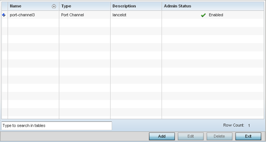

    Device Overrides - Port Channels Screen
    A blue override icon (to the left of a parameter) defines the parameter as having an override applied. To remove an override go to the Basic Configuration section of the device and click Clear Overrides. This removes all overrides from the device.
  4. Refer to the following to review existing port channel configurations and their status to determine whether a parameter requires an override:
    Name The port channel's numerical identifier assigned when it was created. The numerical name cannot be modified as part of the edit process.
    Type Whether the type is port channel.
    Description A short description (64 characters maximum) describing the port channel or differentiating it from others with similar configurations.
    Admin Status A green check mark means the listed port channel is active and currently enabled with the profile. A red “X” means the port channel is currently disabled and not available for use. The interface status can be modified with the port channel configuration as required.
    After reviewing the configurations of existing port channel interfaces, determine whether a new interface needs to be created, an existing interface needs to be edited (overridden), or an existing interface needs to be deleted.
