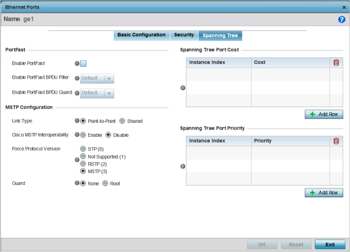

To edit or override spanning tree configuration of the selected port:
  1. Select Spanning Tree tab.
    Ethernet Ports - Spanning Tree Screen
  2. Set the following MSTP Configuration settings:
    Enable as Edge Port
    Select this option to define this port as an edge port. Using an edge (private) port, you can isolate devices to prevent connectivity over this port.
    Link Type
    Select either Point-to-Point or Shared. When Point-to-Point is selected, the port is treated as connected to a point-to-point link. When Shared is selected, the port is shared between multiple devices.
    An example of a Point-to-Point connection is a port that is connected to a controller or service platform.
    An example of a Shared connection is a port that is connected to a hub.
    Cisco MSTP Interoperability
    Enable or Disable interoperability with Cisco‘s version of MSTP over the port. Cisco's version of MSTP is incompatible with standard MSTP.
    Force Protocol Version
    Select STP to use the standard Spanning Tree Protocol. Select RSTP to use Rapid Spanning Tree Protocol. Select MSTP to use Multiple Spanning Tree Protocol.
    Select Not Supported to disable spanning tree protocol for this interface.
    MSTP is the default setting.
    Guard
    Select Root radio to ensure that the port is a designated port. Typically, each guard root port is a designated port, unless two or more ports (within the root bridge) are connected together. If the bridge receives superior BPDUs on a guard root-enabled port, the guard root moves the port to a root-inconsistent STP state. This state is equivalent to a listening state. No data is forwarded across the port. Thus, the guard root enforces the root bridge position. Select None to disable this feature.
    Enable PortFast
    Select this option to enable drop-down menus for both the Enable PortFast BPDU Filter and Enable PortFast BPDU Guard options for the port.
    Select this option to invoke a BPDU filter for this PortFast enabled port. Enabling the BPDU filter feature ensures this PortFast enabled port does not transmit or receive BPDUs.
    Select this option to invoke a BPDU guard for this PortFast enabled port. Enabling the BPDU guard feature means that this PortFast enabled port will shut down when it receives BPDU messages.
  3. Refer to the Spanning Tree Port Cost table.
    Define or override an Instance Index using the spinner control, and set its corresponding cost in the Cost column.
    The default path cost depends on the user-defined speed of the port. The cost helps determine the role of the port in the MSTP network. The designated cost is the cost for a packet to travel from this port to the root in the MSTP configuration. The slower the media, the higher the cost.
    Speed
    Default Path Cost
    <=100,000 bits/sec
    200000000
    <=1,000,000 bits/sec
    20000000
    <=10,000,000 bits/sec
    2000000
    <=100,000,000 bits/sec
    200000
    <=1,000,000,000 bits/sec
    20000
    <=10,000,000,000 bits/sec
    2000
    <=100,000,000,000 bits/sec
    200
    <=1,000,000,000,000 bits/sec
    20
    2
    Select + Add Row as needed to include additional indexes.
  4. Refer to the Spanning Tree Port Priority table.
    Define or override an Instance Index using the spinner control, and set its corresponding priority in the Priority column.
    The lower the priority, the greater likelihood of the port becoming a designated port. Applying a higher override value impacts the port‘s likelihood of becoming a designated port..
  5. Click OK to save the changes and overrides made to the Ethernet port's Spanning Tree configuration.
