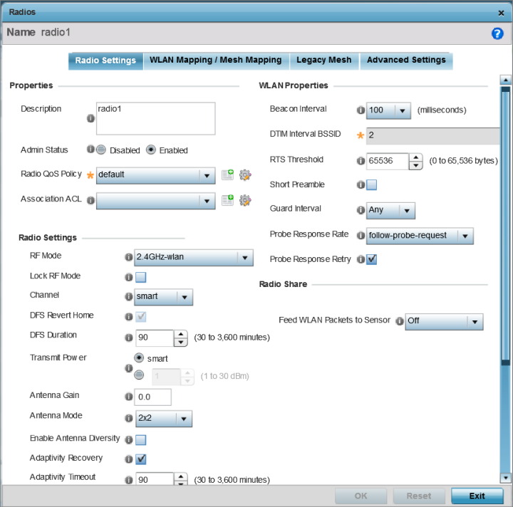

Overriding Radio Settings
If required, you can modify or override a radio's basic configurations at the device level.
  1. Select a radio and click Edit.
    The Radio Settings tab displays by default.
    Access Point Radio - Radio Settings Tab
  2. Define or override the following radio configuration Properties:

  3. Set or override the following Radio Settings for the selected access point radio:
    RF Mode

  5. Use the Feed WLAN Packets to Sensor drop-down menu to allow the radio to send WLAN packets to the sensor radio.
    This feature can be enabled in two modes:
    • In Inline mode, the WIPS sensor receives the packets from the radios with each radio operating in normal mode.
    • In Promiscuous mode, the radio is configured to a mode where it receives all packets on the channel whether the destination address is the radio or not, and the WIPS module can analyze the packets.
    In both Inline and Promiscuous modes, the packets the radio is switching can also be used by the WIPS analysis module.
  6. Click OK to save the changes and overrides to the Radio Settings screen.
