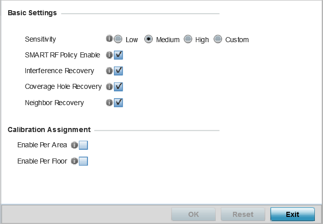

    SMART RF - Basic Configuration Screen
  3. Refer to the Basic Settings field to enable a Smart RF policy and define its sensitivity and detector status.
    Sensitivity Select a radio button corresponding to the desired Smart RF sensitivity. Options include Low, Medium, High, and Custom. Medium is the default setting.
    The Custom option allows an administrator to adjust the parameters and thresholds for Interference Recovery, Coverage Hole Recovery, and Neighbor Recovery. Using the Low, Medium (recommended), and High settings still allows these features to be utilized.
    Smart RF Policy Enable Select this option to enable Smart RF for immediate inclusion within an RF Domain. Smart RF is enabled by default.
    Select this option to enable Interference Recovery from neighboring radios and other sources of WiFi and non-WiFi interference when excess noise and interference is detected within the Smart RF supported radio coverage area. Smart RF provides mitigation from interference sources by monitoring the noise levels and other RF parameters on an Access Point radio‘s current channel. When a noise threshold is exceeded, Smart RF can select an alternative channel with less interference. To avoid channel flapping, a hold timer is defined which disables interference avoidance for a specific period of time upon detection. Interference Recovery is enabled by default.
    Coverage Hole Recovery Select this option to enable coverage compensation from neighboring radios when a radio coverage hole is detected within the Smart RF supported radio coverage area. When a coverage hole is detected, Smart RF first determines the power increase needed based on the signal-to-noise ratio for a client as seen by the access point radio. If a client‘s signal-to-noise value is above the threshold, the transmit power is increased until the signal-to-noise rate falls below the threshold.
    Neighbor Recovery
    Select this option to enable Neighbor Recovery when a failed radio is detected within the Smart RF supported radio coverage area. Smart RF can provide automatic recovery by instructing neighboring APs to increase their transmit power to compensate for the coverage loss. Neighbor Recovery is enabled by default when the sensitivity setting is Medium.
  4. Refer to the Calibration Assignment field to define whether Smart RF Calibration and radio grouping is conducted by area or floor.
    Both options are disabled by default.
  5. Click OK to update the Smart RF basic settings for this policy.
