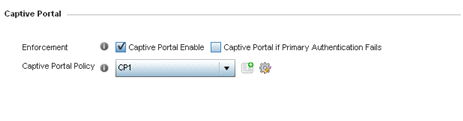

    WLAN Policy Security Screen - Captive Portal Field
  5. Select Captive Portal Enable if authenticated guest access is required with the selected WLAN.
    This feature is disabled by default.
  6. Select Captive Portal if Primary Authentication Fails to enable the captive portal policy if the primary authentication is unavailable.
    This option is enabled only when Captive Portal Enable is selected.
  7. Select the Captive Portal Policy to use with the WLAN from the drop-down menu.
    If no relevant policies exist, select the Create icon to define a new policy to use with this WLAN or the Edit icon to update the configuration of an existing Captive Portal policy. For more information, see Captive Portal Policies.
  8. Select OK when completed to update the WLAN's captive portal configuration.
