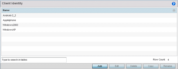

The
Client Identity screen displays, populated
by default with existing client identity configurations.
Device Fingerprinting - Client Identity
Screen
Select
Add to create a new client identity policy,
Edit to modify a selected policy, or
Delete to remove obsolete policies from the list of those available.
Use
Rename to change the name of an existing client identity policy, or
Copy a policy to a different location.

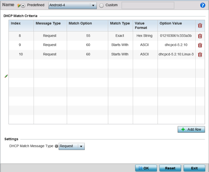

Client identity policies use
signatures to identify and group clients. Signatures are sets of attributes unique to the device model and manufacturer. Once identified, signatures classify and assign network access permissions collectively without having to administer multiple devices individually.
If you are adding a new client identity configuration, define a 32-character maximum name and select the
OK button at the bottom of the screen to enable the remainder of the screen‘s editable parameters.
Select the
+ Add Row button to add a new signature in the client identity.
Device Fingerprinting - Add/Edit - Client Signature Screen
Optionally, select
Pre-defined and choose from a list of pre-defined client identities.
Once selected, the
DHCP Match Criteria field is populated with fingerprints for the selected client identity.
To create a custom identity configuration, select
Custom and provide a name in the adjacent field.
Select the
OK button at the bottom of the screen.
Provide the following information for each device signature configuration:
| Index
Use the spinner control to assign an index (numeric identifier) for this signature. A maximum of 16 signatures can be created.
| Message Type
Use the drop-down menu to designate the DHCP message type matched for signatures.
- Request – Looks for a signature in DHCP request messages. This is the default value.
- Discover – Looks for a signature in DHCP discover messages.
| Match Option
Options are passed in DHCP discover and request messages as Option Code, Option Type, and Option Value sets. When
Option Codes is selected, the Option Code passed in the DHCP discover/request is extracted and a fingerprint is derived. The derived fingerprint is used to identify the device.
- Option – Indicates a specific DHCP Option is used to identify a device. When selected, a text box is enabled to input the DHCP Option used for fingerprinting.
- Option Codes – Indicates the Option Code passed in the DHCP request and discover message is used for matching.
| Match Type
Use the drop-down menu to select how signatures are matched. Available options include:
- Exact – The complete signature string matches the string specified in the
Option Value field.
- Starts-with – The signature is checked if it starts with the string specified in the
Option Value field.
- Contains – The signature is checked if it contains the string specified in the
Option Value field.
| Value Format
Use the drop-down menu to select the character format of the value being checked. The value can be either ASCII or Hexadecimal.
| Option Value
Use this text box to set the 64-character maximum DHCP option value to match.
Use the
DHCP Match Message Type drop-down menu (from the
Settings field at the bottom of the screen) to specify the DHCP message type configured option values are matched against.
The following options are available:
| Discover
| Request
| Any
The fingerprint is checked with either the DHCP request or the DHCP discover message.
| All
The fingerprint is checked with both the DHCP request and the DHCP discover message.
Select
OK to save the changes.
Select
Reset to revert to the last saved configuration.
