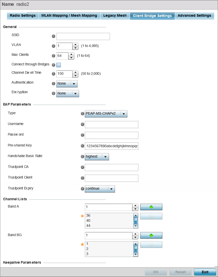

To configure a radio's client bridge settings:
  1. Select the Client Bridge Settings tab.
    The selected radio's client bridge configuration screen displays.
    Radio Interface - Client Bridge Configuration Screen
  2. Define the following General settings:
