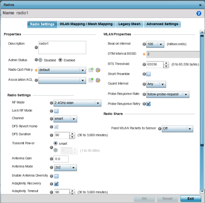

If required, you can modify or override a radio's basic configurations at the device level.
  1. Select a radio and click Edit.
    The Radio Settings tab displays by default.
    Access Point Radio - Radio Settings Tab
  2. Define or override the following radio configuration Properties:

  3. Set or override the following Radio Settings for the selected access point radio:
    RF Mode
    The radio can be configured to provide WLAN service for 2.4 GHz and 5 GHz enabled clients. You can also set the radio to provide sensor support, scan-ahead support, or function as a client bridge.
    Set the mode to either 2.4 GHz WLAN or 5 GHz WLAN depending on the radio's intended client support requirement.

    Lock RF Mode
    Select this option to lock Smart RF calibration functions for this radio. The default setting is disabled.
    Channel
    Select the channel of operation for the radio. Only a trained installation professional should define the radio channel. Select Smart for the radio to scan non-overlapping channels to listen for beacons from other access points. After channels are scanned, the radio selects the channel with the fewest access points. In case of multiple access points on the same channel, it selects the channel with the lowest average power level. The default value is Smart.

  4. Set or override the following WLAN Properties for the selected access point radio:
    Beacon Interval
    Set the interval between radio beacons in milliseconds (either 50, 100 or 200). A beacon is a packet broadcast by adopted radios to keep the network synchronized. Included in a beacon is the WLAN service area, radio address, broadcast destination addresses, a time stamp, and indicators about traffic and delivery (such as a DTIM). Increase the DTIM/ beacon settings (lengthening the time) to let nodes sleep longer and preserve battery life. Decrease these settings (shortening the time) to support streaming-multicast audio and video applications that are jittersensitive. The default value is 100 milliseconds.
