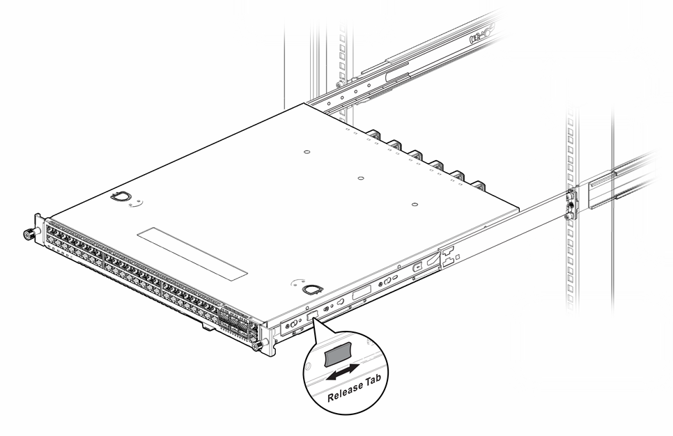

Release the tabs on both slider assemblies, and slide the switch away
from the rear of the rack.
See the diagram below - Removing the Switch from the Slider
Assemblies.
Disengage the retainers that are connecting the mounting brackets with
the sliding rails on both sides.
Carefully slide the switch out of the slider assembly and place it on a
flat surface.

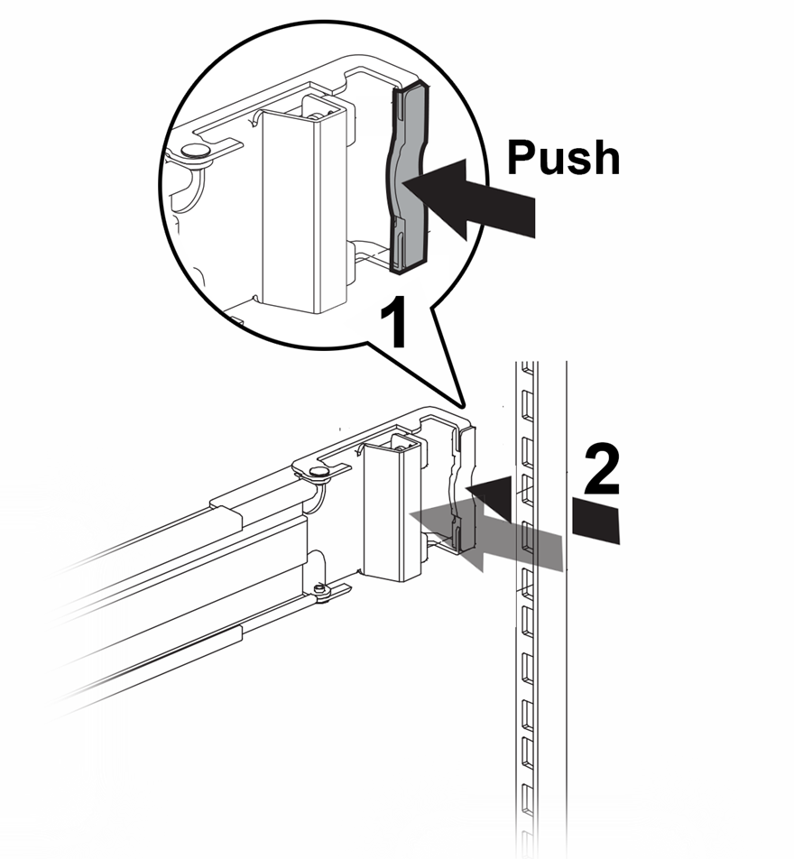

On one of the slider assemblies, push the rear clamp until it separates
from the rear rack post.
See the diagram below - Removing the Slider Assembly: Rear Rack
Post.

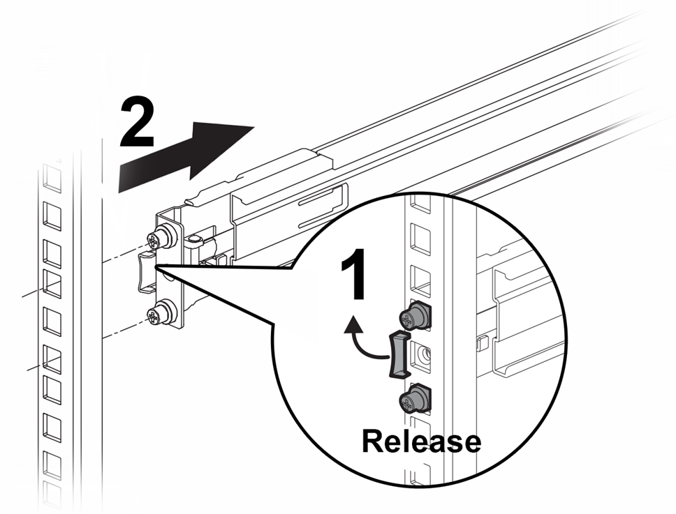

Release the tab that holds the front of the slider assembly to the
front rack post, and pull the pegs out.
See the diagram below - Removing the Slider Assembly: Front Rack
Post .
