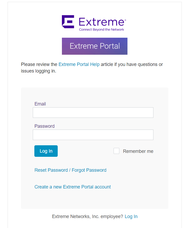

		  Log in to the
			 Extreme Portal at
			 https://extremeportal.force.com/ExtrLicenseLanding.
				If you do not have an Extreme
					portal account, select Create
						a new Extreme Portal account.
 The following figure shows the
					Extreme Portal login window.
					Extreme portal login
							window
				Enter your email and password.
					Click Log
						In.

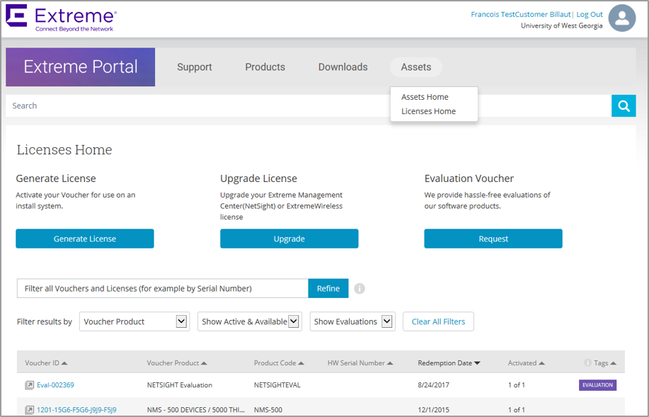

The
Licenses Home
					window appears.
Licenses Home
							window
		   Select
			 Assets
			 Licenses Home option. Click
			 Generate License.

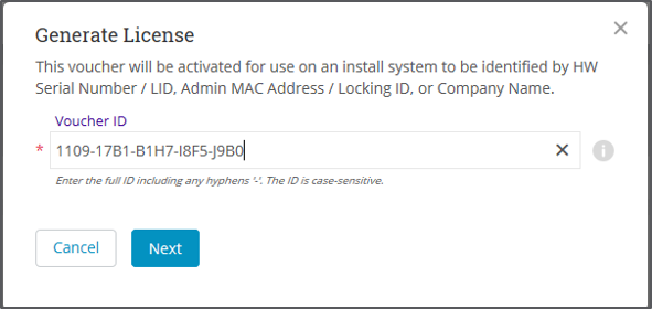

 The
Generate License window is displayed.
		  Enter the VID. Click
			 Next.
The VID has 20 alphanumeric characters
              with hyphens.

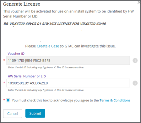

		  Enter the unique identifier of the HW (or the serial number of the LID). Click
			 Submit.
 You must check the box to agree to the Terms and Conditions.
			 HW serial number window
		  The VID is displayed. The example below displays voucher information for a non-capacity license.

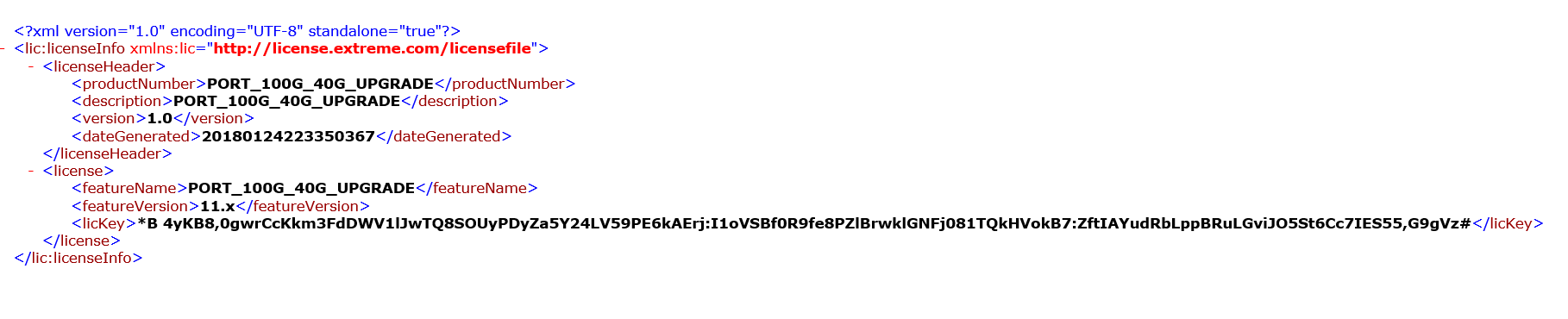

		  In example below, the contents of the XML license are displayed, including the license SKU and license keys.
			 License file window
