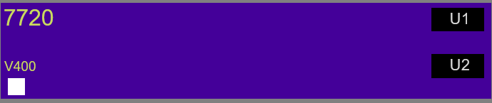

    Each switch model is represented by a rectangle, as shown in the example in the following figure.ach switch model is represented by a rectangle, as shown in the example in the following figure. In this example, stacking ports are represented by U1 and U2 on the right side. Ports 31 and 32 are the actual stacking ports for model 7720-32C.
    7720 Switch Shown in the Stacking Tool
