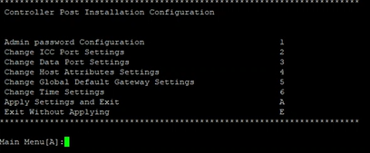

    Controller Post Installation Configuration Menu Screen
    Table 1. Controller Post Installation Configuration Menu
    Menu OptionCommand
    Admin password Configuration1
    Change ICC Port Settings 2
    Change Data Port Settings3
    Change Host Attribute Settings4
    Change Global Default Gateway Settings5
    Change Time Settings6
    Apply Settings and ExitA
    Exit Without ApplyingE
    When you revisit any other screen, you will have to reconfigure all subsequent area settings. For example, if you decide to reconfigure the Admin Password, which is at the beginning of the configuration wizard, you will have to reconfigure all the subsequent configuration wizard settings.
  7. Press Enter to accept the settings. The default option for accepting the settings is A. Your settings are now applied successfully.
