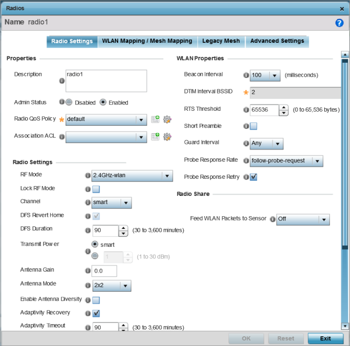

To override a radio's basic settings:
  1. Select the desired radio from the displayed list and click Edit.
    The Radio Settings tab displays by default.
    Radio Interface - Radio Settings Screen
  2. Define or override the following radio configuration Properties:

  3. Define or override the following Radio Settings for the selected access point radio:
    RF Mode

  4. Set or override the following WLAN Properties for the selected access point radio:

  5. Use the Feed WLAN Packets to Sensor drop-down menu to allow the radio to send WLAN packets to the sensor radio.
    Options include Off, Inline, and Promiscuous. The default setting is Off.
