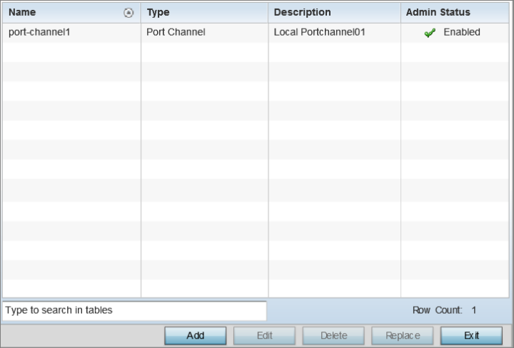

To review an access point's existing VLAN configurations
The existing port channel configurations are displayed.
Name |
The port channel's numerical identifier assigned when it was created. The numerical name cannot be modified as part of the edit process. |
Type |
Whether the type is port channel. |
Description |
A short description (64 characters maximum) describing the port channel or differentiating it from others with similar configurations. |
Admin Status |
A green check mark means the listed port channel is active and currently enabled with the profile. A red “X” means the port channel is currently disabled and not available for use. The interface status can be modified with the port channel configuration as required. |
