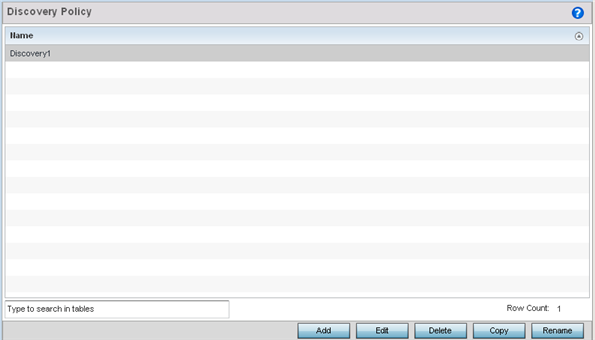

    The Discovery Policy screen displays the name of the configured Bonjour discovery policies.
    Bonjour Gateway - Discovery Policy Screen
  5. Select an existing policy and select Edit to modify its configuration or select Add to create a new configuration..
    Select an existing policy and click Delete to delete the policy, or use Copy to create a copy of a policy for further modifications.

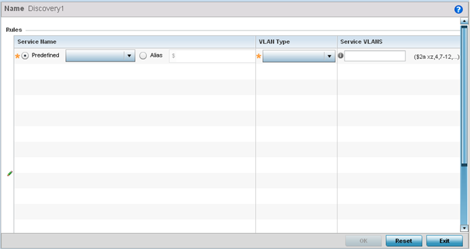

    Bonjour - Discovery Policy - Add/Edit Policy Screen
  6. Select the + Add Row button to add a rule to the Bonjour discovery policy.
    These are the services discoverable by the Bonjour gateway.
  7. Set the following discovery attributes for the discovery policy configuration:
    Service Name Define the service that can be discovered by the Bonjour gateway.
    • Predefined – Use the drop-down menu to select from a list of predefined Apple services (Scanner, Printer, HomeSharing etc.).
    • Alias – Use an existing alias to define a service that is not available in the predefined list.
    VLAN Type Use the drop-down menu to select the VLAN type.
    • local – The VLAN(s) defined in the Service VLAN field use a local bridging mode.
    • tunneled – The VLAN(s) defined in the Service VLAN field are shared tunnel VLANs.
    Service VLANs Provide a VLAN or a list of VLANs on which the selected service is discoverable.
