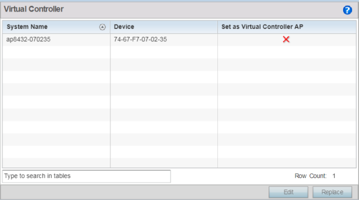

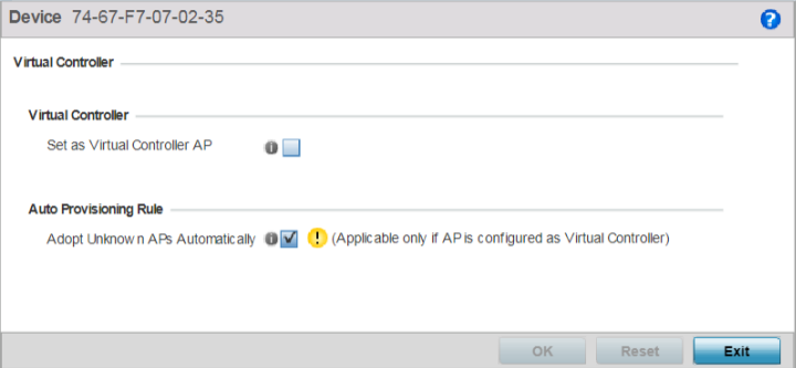

To define a Standalone AP as a Virtual Controller AP:
Click Reset to revert to the last saved configuration. Select Delete to remove obsolete rows as needed.
