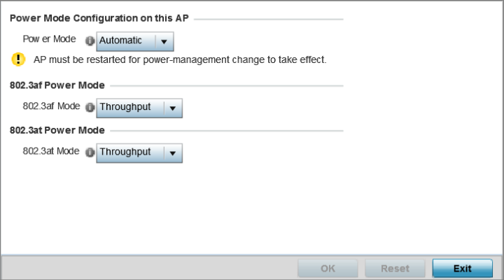

Use the Power screen to set one of two power modes (3af or Auto) for the access point profile. When Automatic is selected, the access point safely operates within available power. Once the power configuration is determined, the access point configures its operating power characteristics based on its model and power configuration.

To define an access point‘s power configuration:
If 802.3af is selected, the access point assumes 12.95 watts are available. If the mode is changed, the access point requires a reset to implement the change.
Select Throughput to transmit packets at the radio‘s highest defined basic rate (based on the radio‘s current basic rate settings). This option is optimal in environments where the transmission range is secondary to broadcast/multicast transmission performance.
Select Range when range is preferred over performance for broadcast/multicast (group) traffic. The data rates used for range are the lowest defined basic rates. Throughput is the default setting for both 802.3af and 802.3at.
