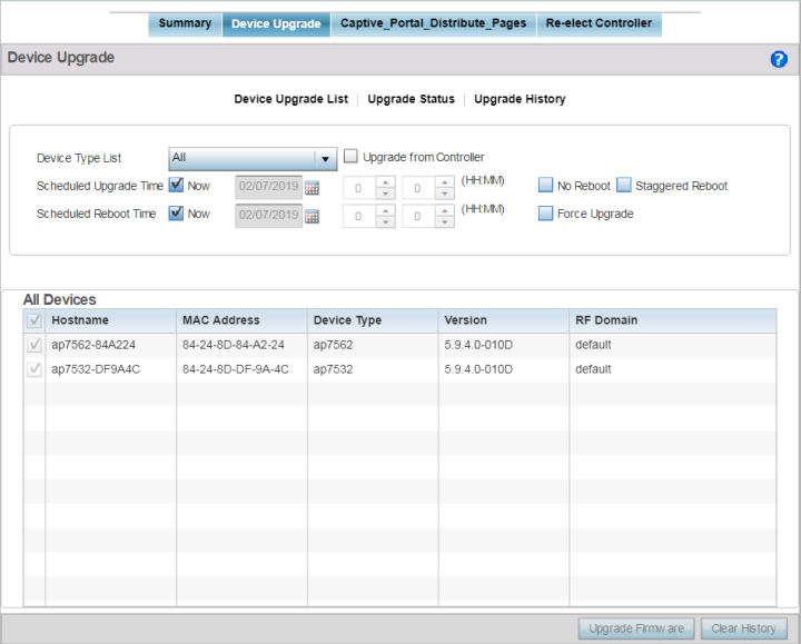

You can configure device upgrade operation at the RF Domain level. RF Domain upgrades happen through the RF Domain manager. The RF Domain manager, requests and receives the firmware from the controller and upgrades RF Domain member devices. Therefore, prior to configuring device upgrade on the RF Domain, ensure the Controller is upgraded to the latest firmware. For more information, see Upgrading Device Firmware.
To configure RF Domain level device upgrade:
Select the All option to initiate upgrade of all devices within the selected RF Domain. If you select this option, the All Devices table is disabled.
By default, both the Scheduled Upgrade Time and Scheduled Reboot Time options are set to Now, which initiates immediate upgrade.
