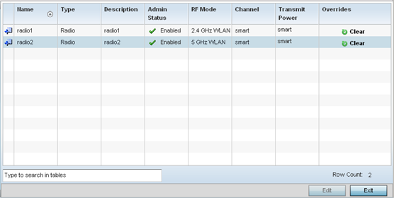

    Device Overrides - Radios Screen
    A blue override icon (to the left of a parameter) defines the parameter as having an override applied. To remove an override go to the Basic Configuration section of the device and click Clear Overrides. This removes all overrides from the device.
  5. Review the following radio configuration data to determine whether a radio configuration needs to be modified or overridden to better support the managed network:
    Name
    Displays whether the reporting radio is radio 1, radio 2 or radio 3. AP 6522, AP 6532, AP 7161 models have 2 radios.
    Type Displays whether the radio has been designated as a typical WLAN radio or if the radio has been designated as a sensor.
    Description A brief description provided by the administrator when the radio's configuration was added or modified.
    Admin Status A green check mark means the radio is enabled for client or sensor support. A red “X” means the radio is currently disabled.
    RF Mode Displays whether each listed radio is operating in the 802.11a/n or 802.11b/g/n radio band. If the radio is a dedicated sensor, it will be listed as a sensor to define the radio as not providing typical WLAN support. If the radio is a client bridge, it provides a typical bridging function and does not provide WLAN support. The radio band is set in the Radio Settings tab.
    Channel Lists the channel setting for the radio. Smart is the default setting. Smart indicates the acces spoint is set for dynamic Smart RF support. If set to Smart, the access point scans non-overlapping channels listening for beacons from other access points. After the channels are scanned, it selects the channel with the fewest access points. In the case of multiple access points on the same channel, it selects the channel with the lowest average power level.
    Transmit Power
    Lists the transmit power for each radio. The column displays smart if Smart-RF is used to set the transmit power for this radio.
    Overrides
    Click Clear to clear overrides made to this radio interface. This field is blank if there are no overrides for this radio.
