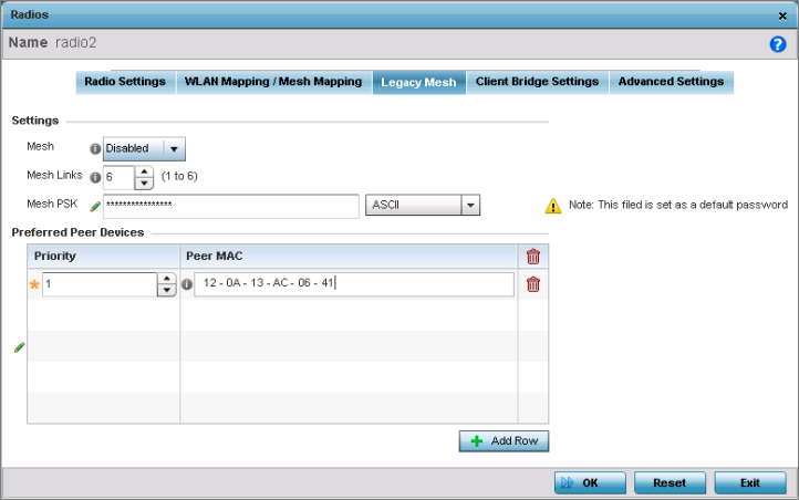

To override a radio's Legacy Mesh configuration:
The Legacy Mesh screen displays. Use this screen to define or override how mesh connections are established and the number of links available among access points within the Mesh network.
Mesh |
Set the mesh mode for this radio – either Client, Portal, or Disabled. Select Client to scan for mesh portals, or nodes that have connection to portals, and connect through them. The Portal operation begins beaconing immediately and accepts connections from other mesh supported nodes. In general, the portal is connected to the wired network. The default value is Disabled. |
Mesh Links |
Specify the number of mesh links (1 -6) an access point radio will attempt to create. The default setting is 3 links. |
Mesh PSK |
Use the field to define the shared key for mesh. From the drop-down, select the type of the key. Click Show to display the characters used in the key. |
Priority |
Use this spinner control to set a priority (1 -6) for connection preference. |
Peer MAC |
For each priority value, define the MAC address of the associated peer device. Use this option to are define MAC addresses representing peer devices for the radio to connect to in mesh mode. |
