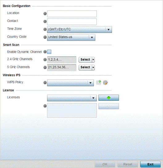

To override a device's RF Domain basic configuration:
A blue override icon (to the left of a parameter) defines the parameter as having an override applied. To remove an override go to the Basic Configuration section of the device and click Clear Overrides. This removes all overrides from the device.| Location | Provide the 64-character maximum deployment location set for the controller or service platform as part of its RF Domain configuration. |
| Contact | Enter the 64-character maximum administrative contact for the controller or service platform as part of its RF Domain configuration. |
| Time Zone | Set the time zone set for the device as part of its RF Domain configuration. |
| Country Code | Set the country code set for the device as part of its RF Domain configuration. Selecting the correct country is central to legal operation. Each country has its own regulatory restrictions concerning electromagnetic emissions and the maximum RF signal strength that can be transmitted. |
| Enable Dynamic Channel | Select this option to enable dynamic channel switching for Smart RF radios. |
| 2.4 GHz Channels | Select legal channels from the drop-down menu for 2.4 GHz Smart RF radios. (Device radios transmit in specific channels unique to their country of operation.) |
| 5 GHz Channels | Select legal channels from the drop-down menu for 5 GHz Smart RF radios. (Device radios transmit in specific channels unique to their country of operation.) |
Click the Create icon to define a new WIPS policy that can be applied to the RF Domain, or click the Edit icon to modify or override an existing WIPS policy.
For an overview of WIPS and instructions on how to create a WIPS policy that can be used with a RF Domain, see Intrusion Prevention.
