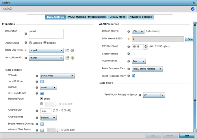

Radio Settings
Use the Radio Settings screen to apply QoS, ACL, operational mode, WLAN attributes and sensor configuration settings to the radio.
To edit an access point's radio settings:
  1. Select the radio and select the Edit.
    The Radio Settings tab displays by default.
  2. Define the following radio configuration parameters from within the Properties field:

  3. Set the following profile Radio Settings for the selected access point radio:
    RF Mode
    The radio can be configured to provide WLAN service for 2.4 GHz and 5 GHz enabled clients. You can also set the radio to provide sensor support, scan-ahead support, or function as a client bridge.

  4. Set the following profile WLAN Properties for the selected access point radio.

  5. Select a mode from the Feed WLAN Packets to Sensor check box in the Radio Share section to enable this feature.
    Select either Inline or Promiscuous mode to allow the packets the radio is switching to also be used by the WIPS analysis module. This feature can be enabled in two modes: an inline mode where the wips sensor receives the packets from the radios with radio operating in normal mode. A promiscuous mode where the radio is configured to a mode where it receives all packets on the channel whether the destination address is the radio or not, and the wips module can analyze them.

  6. Select OK to save the changes made within the screen. Select Reset to revert to the last saved configuration.
