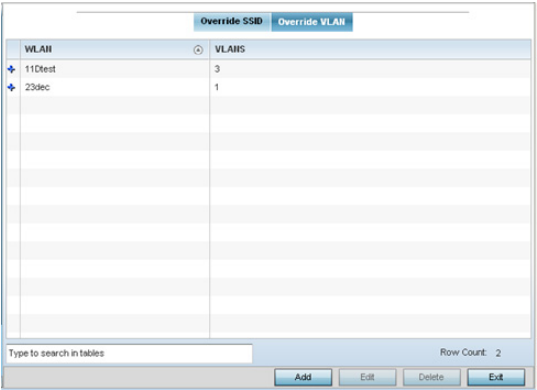

The Override VLAN main screen displays. This screen lists existing WLAN to VLAN assignments.
The VLAN Overrides screen displays.
VLANS |
Set a virtual interface ID (1 - 4094). |
Wireless Client Limit |
Set the number of users permitted on the VLAN. Set the value to 0 to have an unlimited number of users. |
A blue override icon (to the left of a parameter) defines the parameter as having an override applied. To remove an override go to the Basic Configuration section of the device and click Clear Overrides. This removes all overrides from the device.
