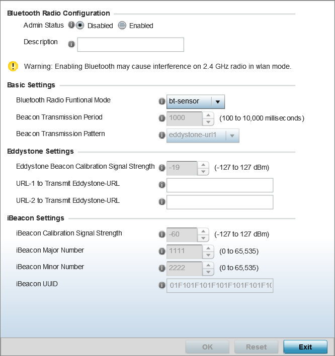

To define a Bluetooth radio interface configuration:
  1. Select Configuration → Devicesfrom the web UI.
    The Device Configuration screen displays in the right-hand UI. This screen lists managed devices or peer controllers, service platforms, or access points.
  2. Select a target access point in the lower left-hand side of the UI.
    You can also select a target device by double-clicking it in the list in the Device Configuration screen.
  3. Select Profile Overrides → Interface.
  4. Select Bluetooth.
    Profile Overrides - Bluetooth Screen
  5. Set the following Bluetooth Radio Configuration parameters:
    Admin Status Enable or Disable Bluetooth support capabilities for AP-8432 or AP-8533 model access point radio transmissions.
    The default value is disabled.
    Description Define a 64 character maximum description for the access point‘s Bluetooth radio to differentiate this radio interface from other Bluetooth supported radio‘s that might be members of the same RF Domain.
  6. Set the following Basic Settings:
    Bluetooth Radio Functional Mode
    Set the access point‘s Bluetooth radio functional mode to either bt-sensor, le-beacon, le-tracking or le-sensor. Use bt-sensor mode for ADSP Bluetooth classic sensing. Use le-beacon mode to have the access point transmit both ibeacon and Eddystone-URL low energy beacons. The bt-sensor option is the default setting.
    Beacon Transmission Period
    Set the Bluetooth radio‘s beacon transmission period from 100 - 10,000 milliseconds. The default setting is 1,000 milliseconds.
    Beacon Transmission Pattern When the Bluetooth radio‘s mode is set to le-beacon, use the enabled drop-down menu to set the beacon‘s emitted transmission pattern to eddystone_url1, eddystone_url2, or ibeacon.
    An eddystone-URL frame broadcasts a URL using a compressed encoding scheme to better fit within a limited advertisement packet. Once decoded, the URL can be used by a client for internet access.
    iBeacon was created by Apple for use in iOS devices (beginning with iOS version 7.0). Apple has made three data fields available to iOS applications: a UUID for device identification, a Major value for device class, and a Minor value for more refined information like product category.
  7. Define the following Eddystone Settings if you have set the Beacon Transmission Pattern to either eddystone_url1 or eddystone_url2:
    Eddystone Beacon Calibration Signal Strength Set the Eddystone Beacon measured calibration signal strength, from -127 dBm to 127 dBm, at 0 meters. Mobile devices can approximate their distance to beacons based on received signal strength. However, distance readings can fluctuate since they depend on several external factors. The closer you are to a beacon, the more accurate the reported distance. This setting is the projected calibration signal strength at 0 meters. The default setting is -19 dBm.
    URL-1 to Transmit Eddystone-URL
    Enter a 64-character maximum eddystone-URL1. The URL must be 18 characters or less once auto-encoding is applied. The encoding process is for getting the URL to fit within the beacon‘s payload.
    URL-2 to Transmit Eddystone-URL
    Enter a 64-character maximum eddystone-URL2. The URL must be 18 characters or less once auto-encoding is applied. The encoding process is for getting the URL to fit within the beacon‘s payload.
  8. Define the following iBeacon Settings if you have set the Beacon Transmission Pattern to ibeacon:
    Beacon Calibration Signal Strength Set the iBeacon measured calibration signal strength, from -127 dBm to 127 dBm, at 1 meter. Mobile devices can approximate their distance to beacons based on received signal strength. However, distance readings can fluctuate since they depend on several external factors. The closer you are to a beacon, the more accurate the reported distance. This setting is the projected calibration signal strength at 1 meter. The default setting is -60 dBm.
    iBeacon Major Number Set the iBeacon major value from 0 - 65, 535. Major values identify and distinguish groups. For example, each beacon on a specific floor in a building could be assigned a unique major value. The default value is 1,111.
    iBeacon Minor Number Set the iBeacon minor value from 0 - 65, 535. Minor values identify and distinguish individual beacons. Minor values help identify individual beacons within a group of beacons assigned a major value. The default setting is 2,222.
    iBeacon UUID
    Define a 32 hex character maximum UUID. The UUID classification contains 32 hexadecimal digits The UUID distinguishes iBeacons in the network from all other beacons in networks outside of your direct administration.
  9. Click OK to save the changes made to the Bluetooth configuration.
