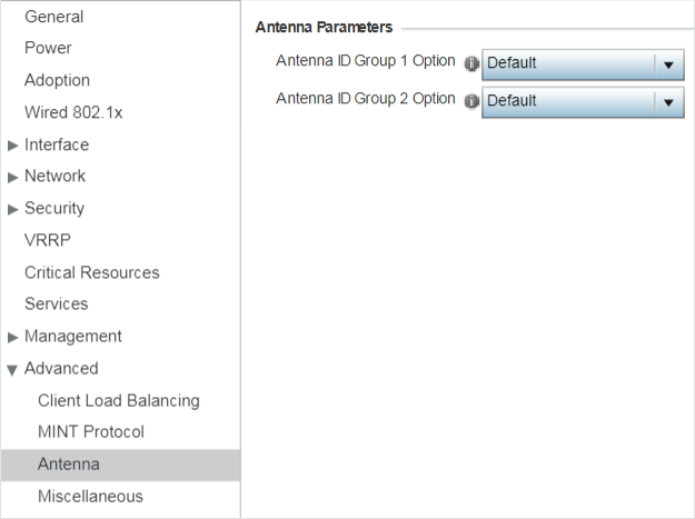

To define or override the AP510e access point profile's antenna-id configuration at the device level:
  1. Select Configuration → Devices → Device Configuration.
  2. Select the target AP510e device.
    The selected device's configuration menu is displayed.
  3. Expand the Advanced menu and select Antenna.
    Advanced Device Overrides - Antenna Screen
  4. Refer to the following to configure the antenna-id:
    Antenna ID Group 1 Option Use this drop-down menu to configure the antenna-id (type of antenna) used in the antenna ports 1 to 4 (group-1 antennas).
    Traffic for all three software modes is routed through antenna ports 1 to 4.
    Note: Refer to the table above for the supported software modes and the corresponding antenna configurations required.
    Antenna ID Group 2 Option Use this drop-down menu to select the antenna-id used in the antenna ports 5 to 8 (group-2 antennas).
    The antenna types supported for 'group-1' and 'group-2' antenna ports are: ai-dq04360s, ml-2452-apa2-01, ml-2452-apa2-02, ml-2452-hpa5-036, ml-2452-hpag4a6-01, ml-2452-hpag5a8-01, ml-2452-pna5-01r, ml-2452-pna7-01r, ml-2452-pta4m4-036, ml-2452-sec6m4-036, ws-ai-dq05120, and Default. The default setting is 'Default'.
    Group-2 antenna configuration is ONLY required for software modes 2 & 3.
  5. Click OK to save the changes made to the profile's advanced antenna configuration.
