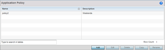

  1. Select Configuration → Network → Application Policy.
    The screen lists the application policy configurations defined thus far.
  2. Refer to the following to determine whether a new application policy requires creation, modification or deletion:
    Name Lists the 32 character maximum name assigned to each listed application policy, designated upon creation.
    Description Displays the 80 character maximum description assigned to each listed application policy, as a means of further distinguishing policies with similar configurations.
  3. Select Add to create a new application policy, Edit to modify the attributes of a selected policy or Delete to remove obsolete policies from the list of those available. Existing policies can be copied or renamed as needed.

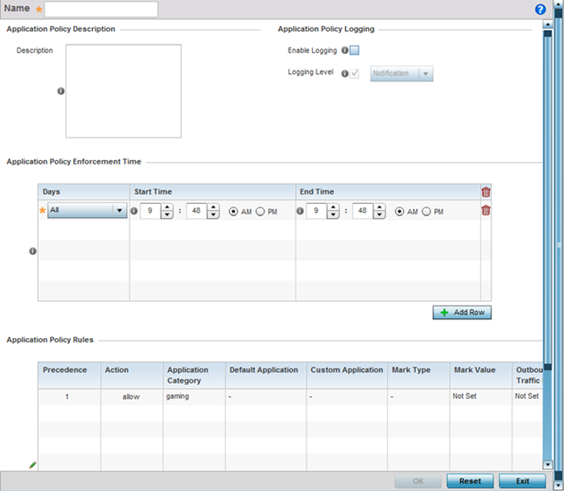

  4. If creating a new application policy, assign it a Name up to 32 characters.
  5. Provide this application policy an 80 character maximum Description to highlight its application and category filters and differentiate it from other policies with similar configurations.
  6. Define the following Application Policy Logging options to enable and filter logging for application specific packet flows:
    Enable Logging Enables the log functionality, where each new flow is shown with the corresponding matched application, the action taken and the policy name. When enabled, logging just shows what applications are getting recognized.
    Logging Level Select this option to log application events by severity. Severity levels include Emergency, Alert, Critical, Errors, Warning, Notification, Information and Debug. The default logging level is Notification.
  7. Refer to the Application Policy Enforcement Time table configure time periods for policy activation for each policy.
    Select + Add Row to populate the table with an enforcement time configuration to activate application policies based on the current local time. The option to configure a time activation period is applicable for a single application policy. Configure the days and time period when the application policy is enforced. If no time enforcement configuration is set, the policy is continually in effect without restriction.
  8. Refer to the Application Policy Rules table assess existing policy rules, their precedence (implementation priority), their actions (allow, deny etc.), application category and schedule policy enforcement restrictions.

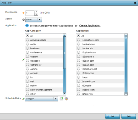

  9. Select + Add Row to launch a screen to create a new policy rule.
  10. Assign the following attributes to the new application rule policy:
    Precedence Set the priority (from 1 - 256) for the application policy rule. The lower the value, the higher the priority assigned to this rule‘s enforcement action and the category and application assigned. A precedence also helps resolve conflicting rules for applications and categories.
    Action Set the action executed on the selected application category and application. The default setting is Allow.
    Application From the App-Category table, select the category for which the application rule applies. Selecting All auto-selects All within the Application table. Select All from the Application table to list all application category statistics, or specify a particular category name to display its statistics only.
  11. Use the Schedule Policy drop-down menu to select an existing schedule policy to strategically enforce application filter policy rules for specific intervals. This provides stricter, time and schedule based, access or restriction to specific applications and their parent categories. If an existing policy does not meet requirements, either select the Create icon to configure a new policy or the Edit icon to modify an existing policy. For more information on configuring schedule policies, see Schedule Policy
