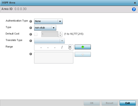

Adding and Editing Area Settings
To define a dynamic routing configuration:
  1. Select Configuration > Profiles > Network.
  2. Expand the Network menu to display its submenu options.
  3. Expand the Network menu and select OSPF.
  4. Select the Area Settings tab.
  5. Select Add to create a new OSPF configuration, Edit to modify an existing configuration or Delete to remove a configuration.
  6. Set the OSPF Area configuration.
    Area ID
    Use the drop-down menu and specify either an IP address or Integer for the OSPF area.
    Authentication Type
    Select either None, simple-password or message-digest as the credential validation scheme used with the OSPF dynamic route. The default setting is None (no data protection).
    Type
    Set the OSPF area type as either stub, totally-stub, nssa, totally-nssa or non-stub.
    Default Cost
    Select this option to set the default summary cost advertised if creating a stub. Set a value from 1 - 16, 777,215.
    Translate Type
    Define how messages are translated. Options include translate-candidate, translate always and translate-never. The default setting is translate-candidate.
    Range
    Specify a range of addresses for routes matching address/mask for OSPF summarization.
  7. Select the OK button to save the changes to the area configuration. Select Reset to revert to the last saved configuration.
