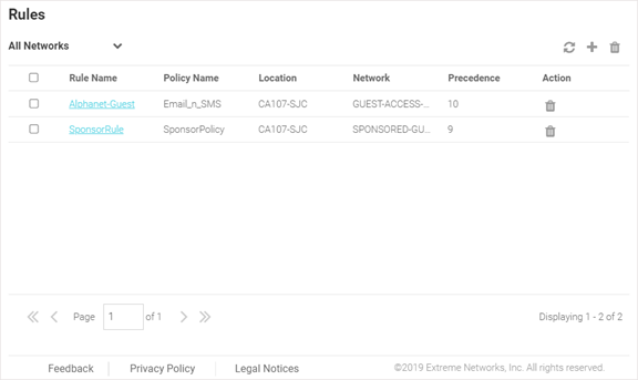

The Rules screen displays existing notification rules and their basic configuration. Double-click each rule to view the detailed configuration. Review the configuration details to determine if the rule warrants modification or removal.
| Rule Name | Displays the unique name assigned to the rule when it was created. |
| Policy Name | Displays the name of the notification policy associated with the rule when it was created. |
| Location | Displays the site that the notification rule applies to. |
| Network | Displays the Network that the notification rule applies to. |
| Precedence | Displays the precedence (sequence) of the rule. The precedence value of a rule determines its priority. Rules with higher precedence receive higher priority and are applied first. This value is set (from 1 - 1000) for new notification rule configurations. |
| Action | Deletes a notification rule. To delete
a rule, select the checkbox next to it and then select the icon
associated with the rule. |
