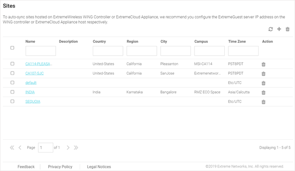

The Sites screen lists sites attached to the ExtremeGuest application. It provides description and location information for sites.
For ExtremeWireless WiNG deployments, enter the ExtremeGuest IP address on the WiNG Controller or AP for automatic synchronization of sites. In these deployments there is no need to add or edit sites.
For ExtremeCloud Appliance deployments, enter the ExtremeGuest IP on the ExtremeCloud Appliance host for automatic synchronization of sites. In these deployments there is no need to add or edit sites.
| Name | Displays the name
associated with each site. Double-click the required site name from
the displayed list. The site details open as a dialogue box, where
you can edit the site's Name,
Description, Country, Region, City,
Campus, Time
Zone, Latitude or Longitude. ![]() Note To filter by name or portion of a name, enter the string in the box at the top of the Name column. The screen updates with sites having names matching the specified string. To clear the filter select the icon. |
| Description | Displays the description associated with each site. |
| Country | Displays the name of
the country for each site.![]() Note To filter by country name or portion of a country name, enter the string in the box at the top of the Country column. The screen updates with sites having country configuration matching the specified string. To clear the filter select the icon. |
| Region | Displays the optional
region associated with each site such as the state, province, or
county.![]() Note To filter by region name or portion of a region name, enter the string in the box at the top of the Region column. The screen updates with sites having region configuration matching the specified string. To clear the filter select the icon. |
| City | Displays the optional
city associated with each site.![]() Note To filter by city name or portion of a city name, enter the string in the box at the top of the City column. The screen updates with sites having city configuration matching the specified string. To clear the filter select the icon. |
| Campus | Displays the optional
campus name configured for each site.![]() Note To filter by campus name or portion of a campus name, enter the string in the box at the top of the Campus column. The screen updates with sites having campus configuration matching the specified string. To clear the filter select the icon. |
| Time Zone | Displays an
abbreviated version of the optional time zone configured for each
site.![]() Note To filter by time zone, enter the abbreviated time zone name in the box at the top of the Time Zone column. The screen updates with sites falling within the specified timezone. To clear the filter select the icon. |
| Action | Select the icon to remove the site from
ExtremeGuest. |
icon to update the data in the sites table.
icon to add a new site.
