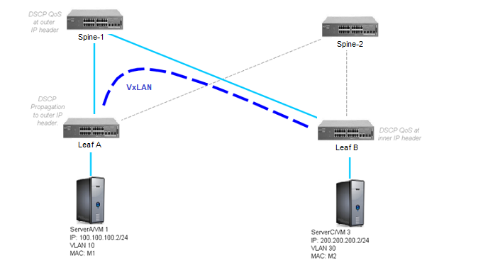

A VxLAN Layer 3 gateway allows inter-subnet communication through the VxLAN configuration. In the following figure, the leaf nodes act as the VxLAN Layer 3 gateway. Spine-1 and Spine-2 act as IP routing nodes that route the VxLAN packet out between Leaf-A and Leaf-B. Hosts on different subnets cannot learn MAC addresses of each other in a VxLAN network.
The leaf nodes resolve ARP for a tenant VM. The leaf nodes advertise the host routes to each other and tenant VMs with the next hop configured as VTEP. In the following figure, VM1 on a VxLAN network is sending a packet to VM3 on a VxLAN network.
VxLAN QoS DSCP:
At Ingress-VTEP, incoming packet‘s IP DSCP derives Traffic-Class (TC). Derived TC is then used to derive the outer DSCP value for VxLAN Encapsulated packet which is sent out via Tunnel Interface.
At the Egress-VTEP, incoming VxLAN encapsulated packet‘s outer DSCP value is used to derive Traffic-Class(TC). Post-Decapsulation, packet‘s VLAN PCP is derived from the TC derived above and, packet‘s DSCP value is derived based on “QoS-DSCP-mode” config.
