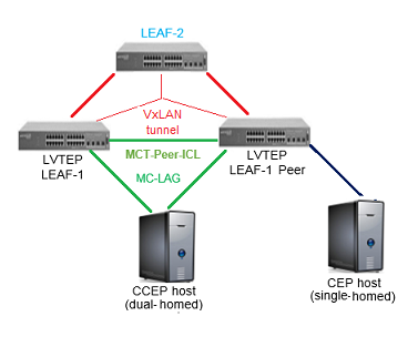

This section discusses the Layer 3 functionality support on such a logical VTEP (LVTEP).
The following figure illustrates a VxLAN LVTEP
topology.
VxLAN LVTEP topology
The LVTEP is formed through MCT peering
(spoke-PW-peer) between Leaf-1 and its peer node, Leaf-2-peer, to provide redundancy for
a VxLAN leaf node.
A VxLAN tunnel is created between such an LVTEP
leaf and a remote leaf. The source IP address of the VxLAN tunnel is the same on both
nodes. Therefore, the tunnel has a single tunnel representation on the remote leaf
(Leaf-2 in the figure ). The logical connection of the tunnel is shown as thin red line.
The single tunnel on Leaf-2 has two underlay
paths to reach Leaf-1 and the Leaf-1 peer. Any traffic south bound from Leaf-2 is load
balanced and ends up in either of the LVTEP peers.
