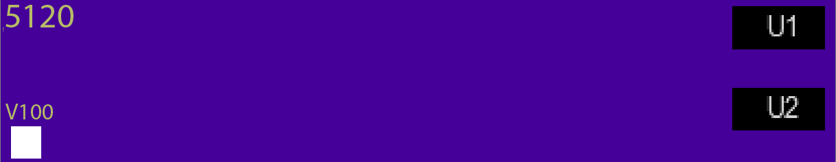

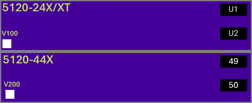

  2. Find a switch model in the Switches column.
    Each switch model is represented by a rectangle, as shown in the example in the following figure.ach switch model is represented by a rectangle, as shown in the example in the following figure.
    5120 Switches Shown in the Stacking Tool

    Select a rectangle to display more information about the switch model and the VIMs (if any) that it can use for stacking.
