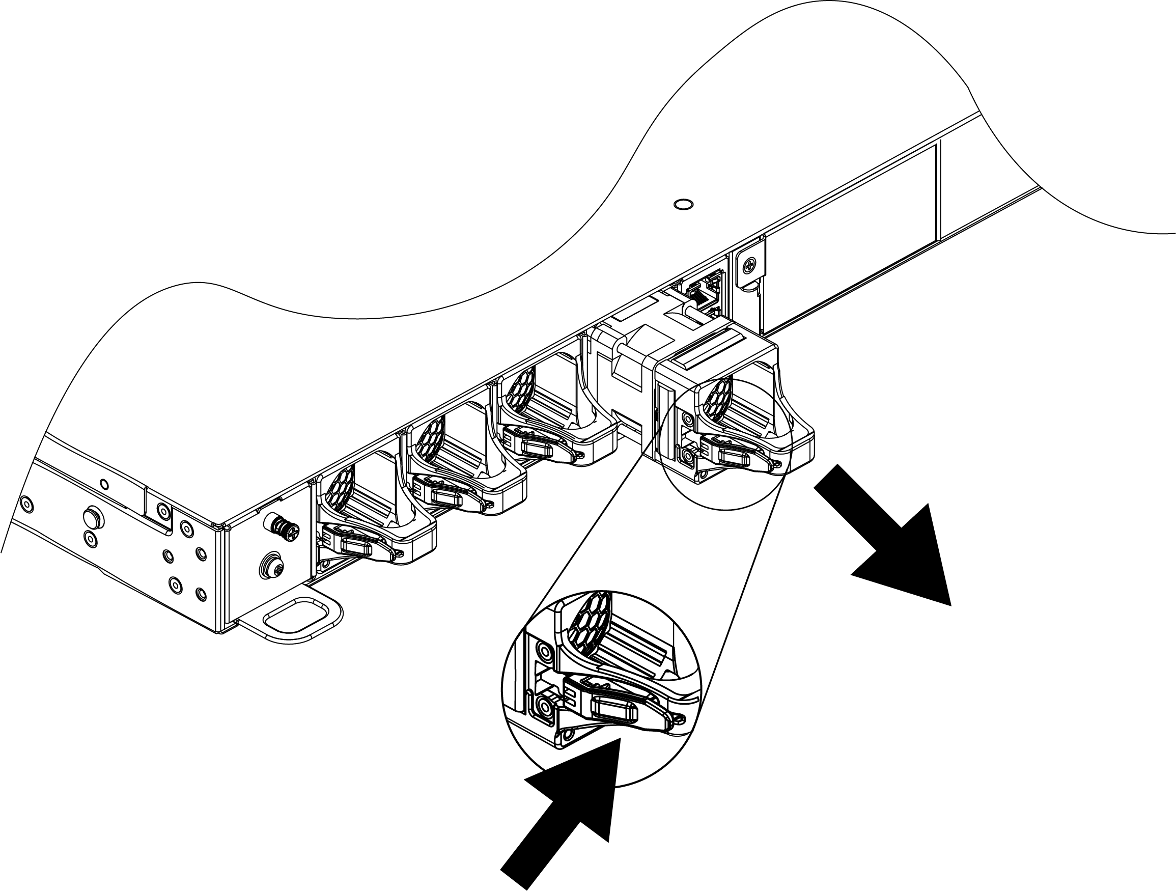

Remove a Fan Module
Use the following instructions to remove a fan module.
  1. Push the latching tab toward the fan module handle and pull outward on the handle to disengage the fan module internal connectors, as shown in Removing a Fan Module.
  2. Carefully slide the fan module the rest of the way out of the switch.
    If you are not installing a replacement fan module, install a cover over the unoccupied fan module slot. Unoccupied slots must always be covered to maintain proper system ventilation.

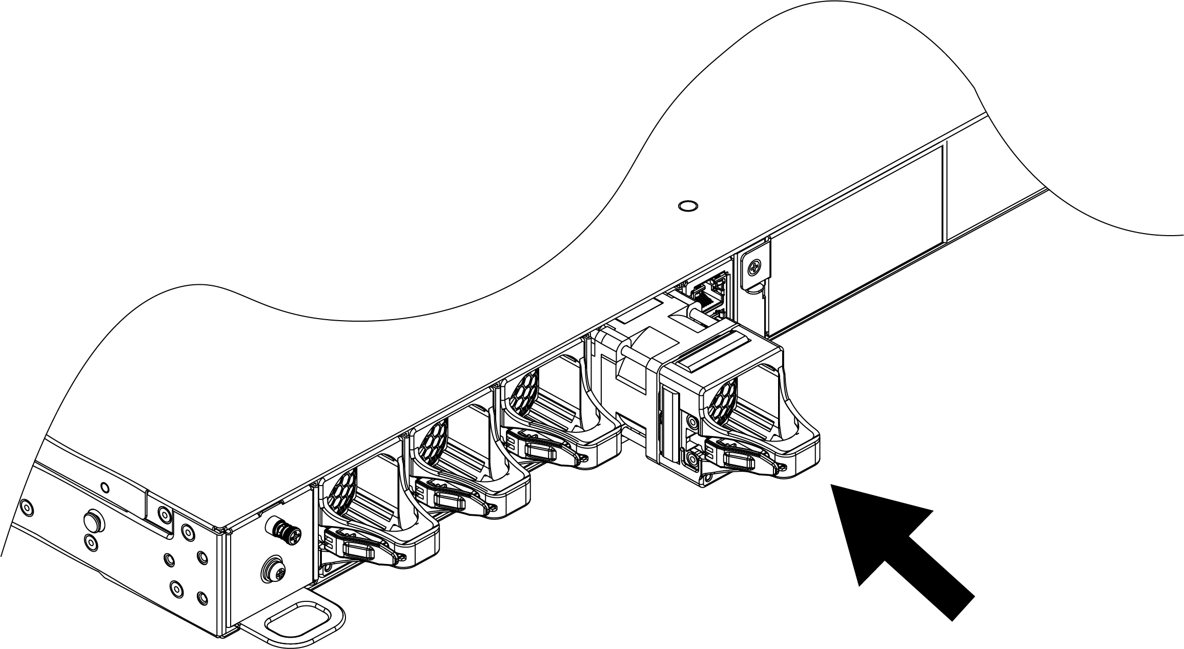

Install a Fan Module
Use the following instructions to install a fan module.
  1. Verify that the airflow direction on the replacement fan module matches that of the installed fan modules.
    Fan modules labeled Air Out provide front-to-back airflow.
  2. Carefully slide the replacement fan module all the way into the fan module slot, as shown in Installing a Fan Module.
  3. Push the fan module in until the latch snaps into place.
    Caution
    Caution
    Do not slam the fan module into the switch.
