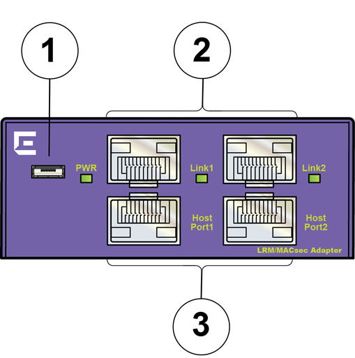

The front panel of the LRM/MACsec adapter includes:
LRM/MACsec Adapter: Front Panel
