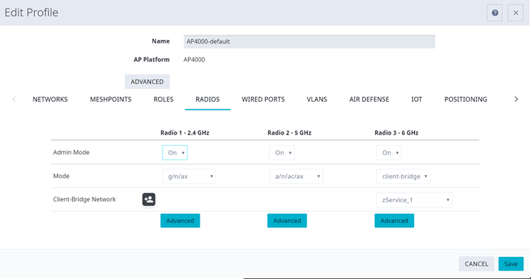

  4. From the Radios tab, select Client Bridge as the Radio Mode value for either radio.
    Consider the following when configuring a radio as a Client Bridge:
    • Only one radio can be configured as a Client Bridge. This can be either radio. Regardless of which radio is configured as the Client Bridge, both radios will continue to provide service.
      • Radio 1 enables Client Bridge on the 2.4GHz band only.
      • Radio 2 enables Client Bridge on the 5GHz band only.
    • The Client Bridge radio will connect on the radio channel that is determined by the infrastructure AP.
    • When Client Bridge is configured on a single interface AP, the single interface is used as the client port, not as an uplink, and you will not see the ETH1 Port Function field in the Profile Advanced dialog.
    • Eight networks can be configured per radio. If one network is configured as a Client Bridge, seven additional networks can be configured for service on that radio.
  5. Select the Client Bridge Network.

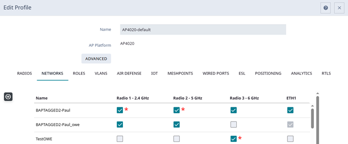

  8. If you are planning to connect the end-system to the Client Bridge AP through the ETH1/GE2 port, edit the configuration Profile again.

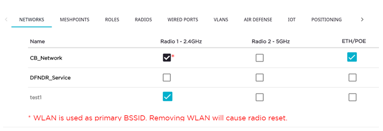

  9. On the Networks tab, the Client Bridge network is indicated with a black highlight.
    The Client Bridge is always assigned the primary BSSID (Basic Service Set Identifier). If you change the Client Bridge network assignment, the radio is reset, resulting in a service interruption.
  10. On the Networks tab, select ETH1 port.
    Only allow one network assignment to Client Bridge and ETH1/GE2 interfaces respectively.
    Configuration Profile Network Configuration – Client Bridge
    Configuration Profile Networks tab shows network selected for Client Bridge.
