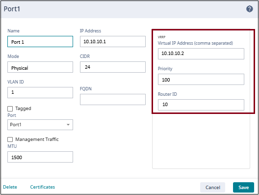

VRRP Configuration (on Data Port of Universal Compute Platform)
After the cluster is created, go to Administration > System > Network Setup and configure VRRP on the data port that you configured using the wizard. Add the following VRRP settings to the existing port configuration:
  • Virtual IP Address=10.10.10.2
  • Priority=100
  • Router ID=10

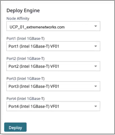

On Universal Compute Platform, go to Engines > Installation and Install the Tunnel Concentrator application.
After installation, select the link for the freshly installed instance. On the Deploy Engine page, assign the following engine settings and deploy the engine:
  • Node Affinity=UCP_01.extremenetworks.com
  • Port1=Port1(Intel GBase-T) VF01
  • Port2=Port2(Intel GBase-T) VF01
  • Port3=Port3(Intel GBase-T) VF01
  • Port4=Port4(Intel GBase-T) VF01
