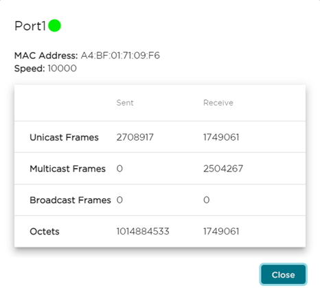

StatsSelect the link to open a popup that displays more information on the port. Depending on the type of port, the popup may display:
  • MAC address of the port
  • Port speed (in bits per second)
  • Frames sent and received (depending on port and traffic, this figure may be split by unicast, multicast, and broadcast traffic)
  • Octets sent and received
Port Statistics
Port Statistics
