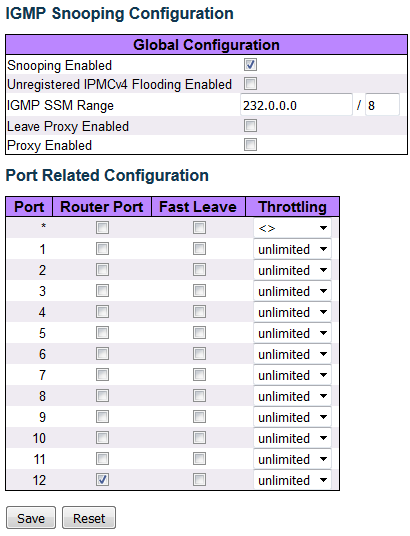

Example 2
Navigate to
Configuration
IPMC
Basic Configuration
Select the
Snooping Enabled
check box.
Clear the
Unregistered IPMCv4 Flooding Enabled
check box.

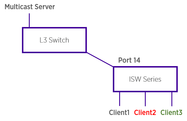

If Multicast stream is from L3 switch, then the uplink port must be “Router Port.”
If an aggregation member port is selected as a router port, the whole aggregation will act as a router port.

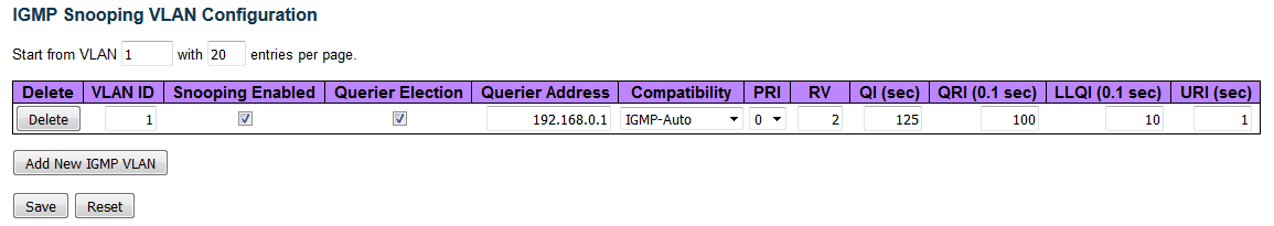

Go to
Configuration
IPMC
VLAN Configuration
Select the
Snooping Enabled
check box.
Set
VLAN
ID of port14.
