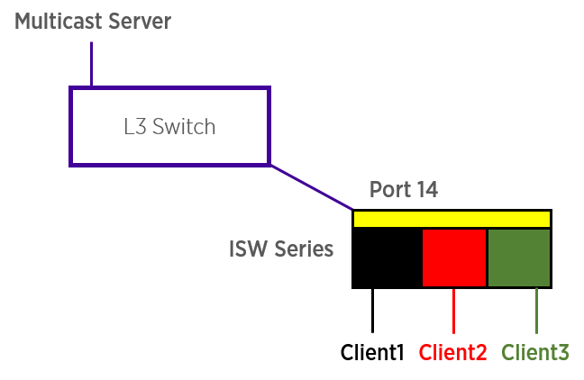

In this scenario, these clients belong to multiple VLANs, so you have to create more one VLAN to be the agent for all client VLANs.

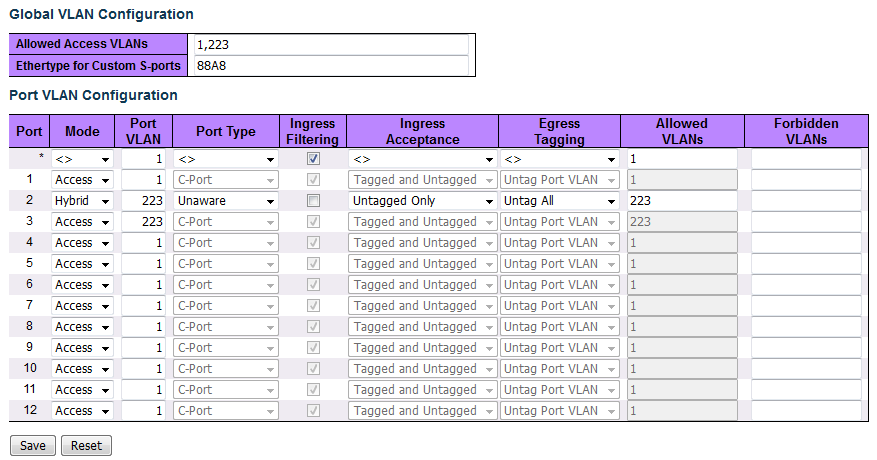

  1. To create a VLAN, navigate to ConfigurationVLANsAllow Access VLANs.
  2. Set port 14 be vlan200 member port.
  3. Navigate to ConfigurationIPMCVLAN Configuration.
  4. Select the Snooping Enable check box.
  5. Set VLAN ID of port14.
  6. If there is no querier on the L3 switch, you have to select Querier Election, and set the Querier Address. The IP address is in the same network as uplink interface.
  7. Select the IGMP version as server.
