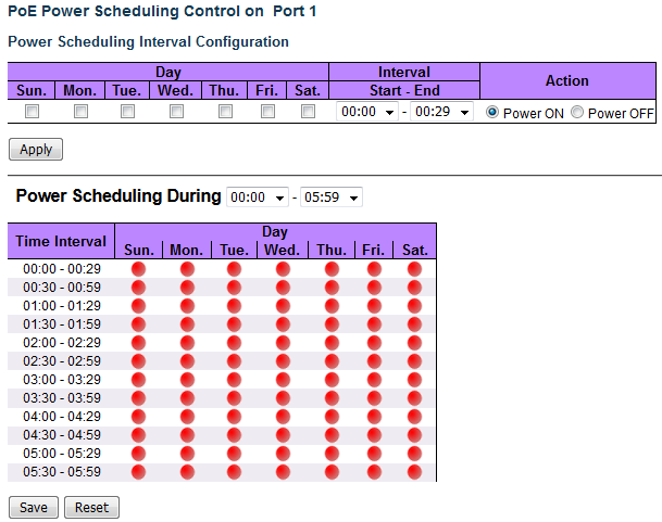

The power scheduling is used to control the power alive interval on PoE port. It is allowed to set the specific interval to schedule power on/off in one week.
The current scheduling state is displayed graphically during the week. Green indicates the power is on and red that it is off. Directly changes checkmarks to indicate which day are members of the time interval. Check or uncheck as needed to modify the scheduling table.
Day
Checkmarks indicate which day are members of the set. From Sunday to Saturday.
Interval
There are 48 time interval one day. Each interval has 30 minutes.
  • Start - Select the start hour and minute.
  • End - Select the end hour and minute.
Action
  • Power On - Select the radio button to apply power on during the interval.
  • Power Off - Select the radio button to apply power off during the interval.

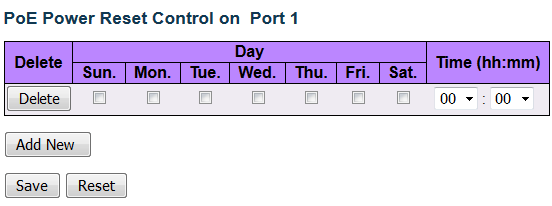

PoE Power Reset
The entry is used to control the power reset time on PoE port.
It is allowed to create at maximum five entries for each PoE port.
