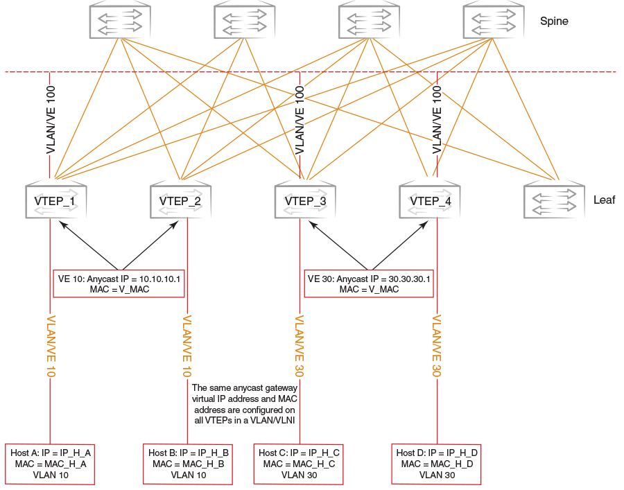

To make this movement of host from one leaf switch to another seamless, all the leaf switches are configured with the same anycast IP address and the associated virtual MAC (VMAC or anycast MAC) address for a given VLAN/BD. This configuration allows any leaf switch to behave as the default gateway for the host and allows for the most optimal forwarding behavior.
The ingress leaf switch recognizes the VMAC address as its own MAC address and does Layer 3 forwarding.
As shown in the following figure, for VLAN 10, all leaf switches are configured with the same MAC address and IP address.
Static anycast gateway
When the host sends an ARP request for the gateway IP address on VLAN 10, the ingress leaf switch intercepts the ARP request and responds with the VMAC address associated with anycast IP. This behavior is controlled for each VE interface.
