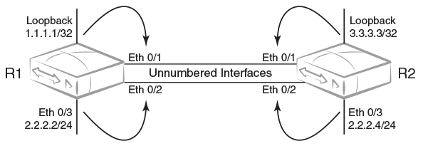

The following diagram illustrates the overall concept of unnumbered interfaces and donor interfaces.
IP unnumbered and donor interfaces
