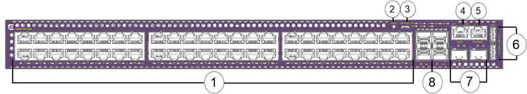

5420F-48P-4XE Switch Features
The front panel of the 5420F-48P-4XE switch includes:
- 1 = 48 x 10/100/1000BASE-T full/half duplex (autosensing) MACsec capable
ports with Type 2 PoE+ (30W)
Half-duplex is not supported on these ports when operating at 1Gbps.
- 2 = Mode button
- 3 = USB Micro-B console port
- 4 = 10/100/1000BASE-T Out-of-band management port
- 5 = Serial console port (RJ-45)
- 6 = 2 x USB Type A port for
management or external USB flash
- 7 = 2 x SFP-DD Universal ports/Stacking ports (unpopulated)
- 8 = 4 x 1/10Gb SFP+ MACsec
capable uplink ports (unpopulated)
If you are trying to activate a MACsec license on a 5420F-48P-4XE switch with
hardware revision AC, contact GTAC for the latest support information.
5420F-48P-4XE Front Panel

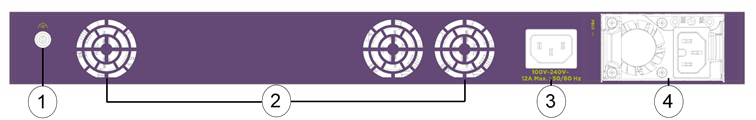

The rear panel of the switch includes:
- 1 = Grounding lug
- 2 = 3 x Fixed fan modules
- 3 = AC power inlet connector
- 4 = Power supply slot (unpopulated)
5420F-48P-4XE Rear Panel
