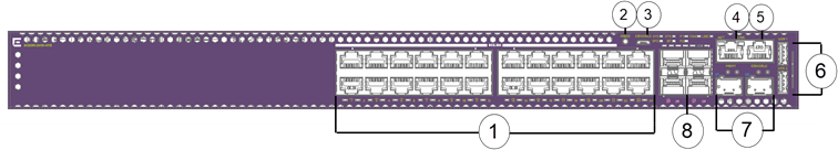

5420M-24W-4YE Switch Features
The front panel of the 5420M-24W-4YE switch includes:
- 1 = 24 x 10/100/1000BASE-T full/half duplex (autosensing) MACsec capable
ports with 802.3bt Type 4 PoE (90W)
Half-duplex is not supported on these ports when operating at 1Gbps.
- 2 = Mode button
- 3 = USB Micro-B console port
- 4 = 10/100/1000BASE-T Out-of-band management port
- 5 = Serial console port (RJ-45)
- 6 = 2 x USB Type A port for
management or external USB flash
- 7 = 2 x SFP-DD Universal ports/Stacking ports (unpopulated)
These ports can operate either as stacking ports, or as 10G Ethernet ports with SFP+
optics using the
disable stacking-support command.
- 8 = 4 x 1/10/25Gb SFP28 MACsec capable uplink ports (unpopulated)
5420M-24W-4YE Front Panel

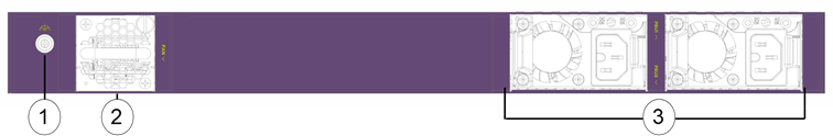

The rear panel of the switch includes:
- 1 = Grounding lug
- 2 = Fan module
- 3 = 2 x Power supply slots
(unpopulated)
5420M-24W-4YE Rear Panel
