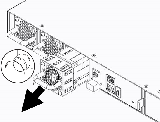

  1. Completely loosen the captive retaining screws on the fan module.
    On most switch models, the fan module has two retaining screws at the bottom corners of the module, as shown in Removing a Fan Module.
    On some switch models, the fan module has a single retaining screw at the top right corner of the module.
  2. Slide the fan module out of the switch and set it aside.
    Removing fan module with arrow and unscrew direction

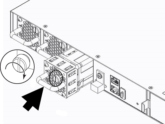

  4. Carefully slide the replacement fan module into the switch.
    Installing a Fan Module
    Installing fan module with arrow and screw direction
  5. Align and fully tighten the captive retaining screws.
