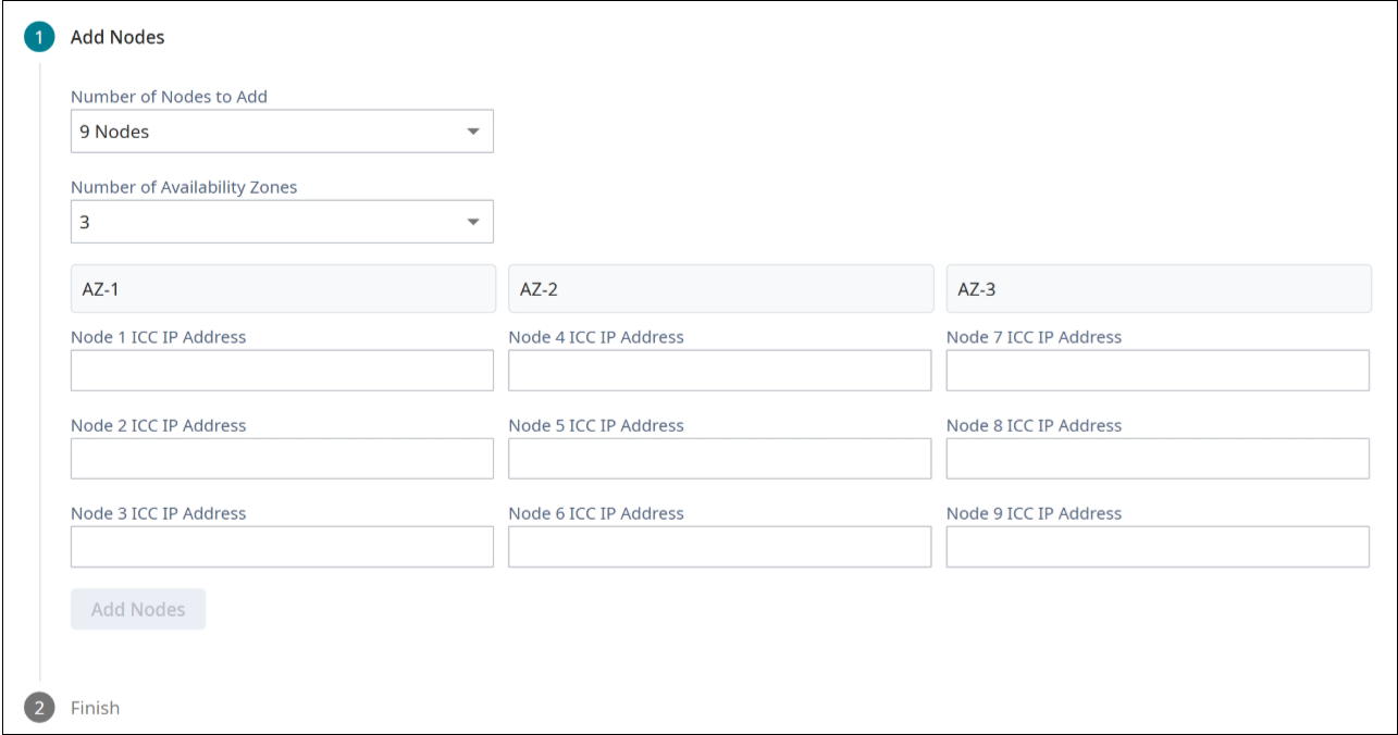

  2. Update the cluster configuration to include the new nodes. On the primary cluster node, do the following:
    1. Go to Cluster Settings > Add Node.
    2. In the Number of Nodes to Add drop-down, select the number of nodes that you are adding.
    3. From the Number of Availability Zones drop-down, select the number of availability zones to which you are adding nodes.
      This setting appears only if the existing cluster has multiple availability zones configured.
      Keep the following points in mind when adding new nodes to a cluster that is split into multiple availability zones:
      • Each availability zone must have the same number of nodes per zone with a minimum of three nodes per zone.
      • If the existing cluster has three zones, you must add nodes in multiples of three.
      • If the existing cluster has two zones, you must add nodes in multiples of six.
      • You cannot reconfigure the number of availability zones in an existing cluster. The cluster must have the same number of zones before and after the node additions.
      For more information, see Availability Zones.
      Add Nodes with Multiple Availability Zones
    4. Enter the ICC IP Address for each new node and then select Add Nodes.
    5. Select OK.
