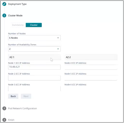

  2. In the Cluster Mode section, select Cluster and do the following:
    1. From the Number of Nodes to Add drop-down, select the number of nodes for the cluster.
    2. From the Number of Availability Zones drop-down, select the number of availability zones for the cluster. You can assign up to three zones (the default is one).
    3. Enter the ICC IP addresses that you have assigned to each node.
      If you are deploying multiple availability zones, make sure that each ICC address falls under the zone where you want to deploy that node. Note that each zone requires a minimum of three nodes. For more information, see Availability Zones.
    4. Select Next.

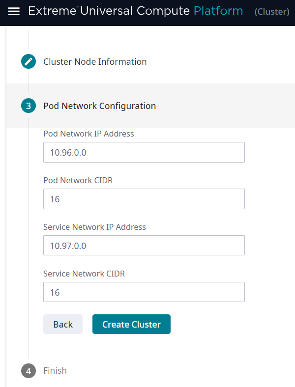

  3. Provide the following network settings for Pod Network Configuration:
    • Pod Network IP Address—Enter a network address. The default is 10.96.0.0.
    • Pod Network CIDR—Enter the number of digits for the pod network mask. The default is 16.
    • Service Network IP Address—Enter a network address. The default is 10.97.0.0.
    • Service Network CIDR—Enter the number of digits for the service network mask. The default is 16.

  4. Select Create Cluster.

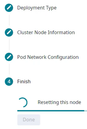

    Cluster Creation Process
  5. Select Done.
    Deployment Health Dashboard displays results
    Once the cluster has been created, going to the Cluster Configuration page displays a read-only view of cluster configuration settings.
